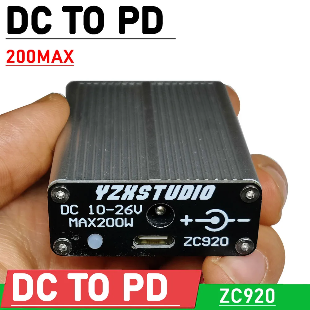

US $2.71 46% Off | USB Boost Converter DC 5V to 9V 12V USB Step-up Converter Cable + 3.5x1.35mm Connecter For Power Supply/Charger/Power Converter
