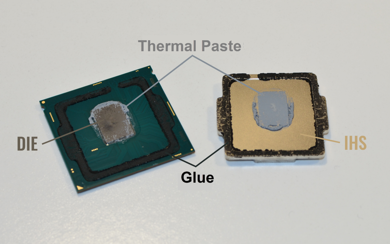

IHS stands for integrated heat spreader. The IHS is the metal exterior lid of a CPU’s processor. It serves as both a protective shell around the processing silicon and a pathway for heat to be exchanged between the CPU and your CPU cooler.
io-tech käyttää IHS:tä suomennosta "lämmönlevittäjä", esim. tässä artikkelissa (3. kuva artikkelin alusta):
