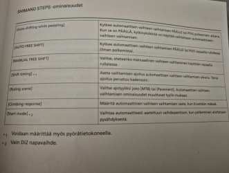

Tuossa Helkaman ohjeissa on toiminnosta maininta, kyseessä on Start Mode mikä vaihtaa vaihteen automaattisesti pieneksi pysähdyksistä lähdettäessä.

Now I noticed that the bike automatically shifts to 2nd gear when it stops. So I'm using a manual transmission, not an automatic. Somehow it feels like it wasn't like that at first, of course I could be wrong, I've only ridden it a little.
It's mentioned in the SC-EN500 manual:
"If the bicycle has a Di2 internal geared hub, you can set/change the gear position when starting from a stop."
