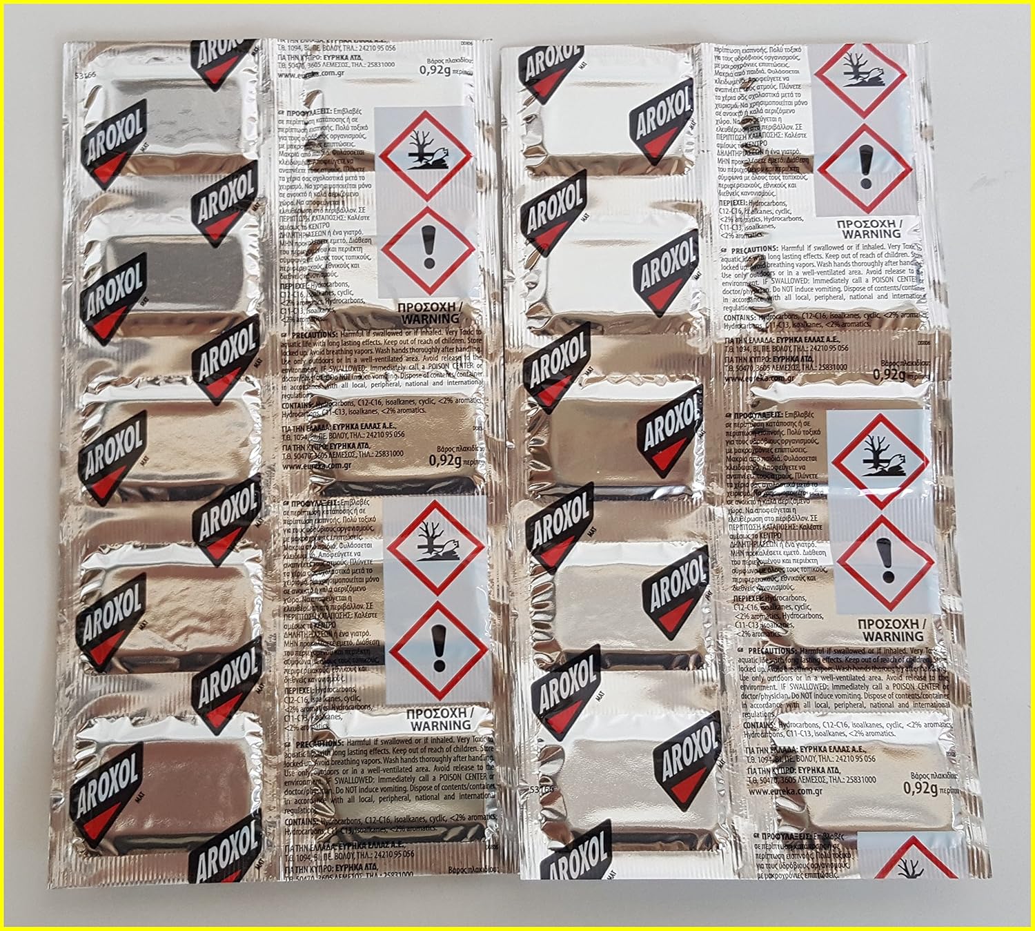

AROXOL - Mat Tablets Refills Mosquito (Tiger) Insect Flies Bite Repellent
Vaikuttava aine: D-Allethrin 4.5% w/w
