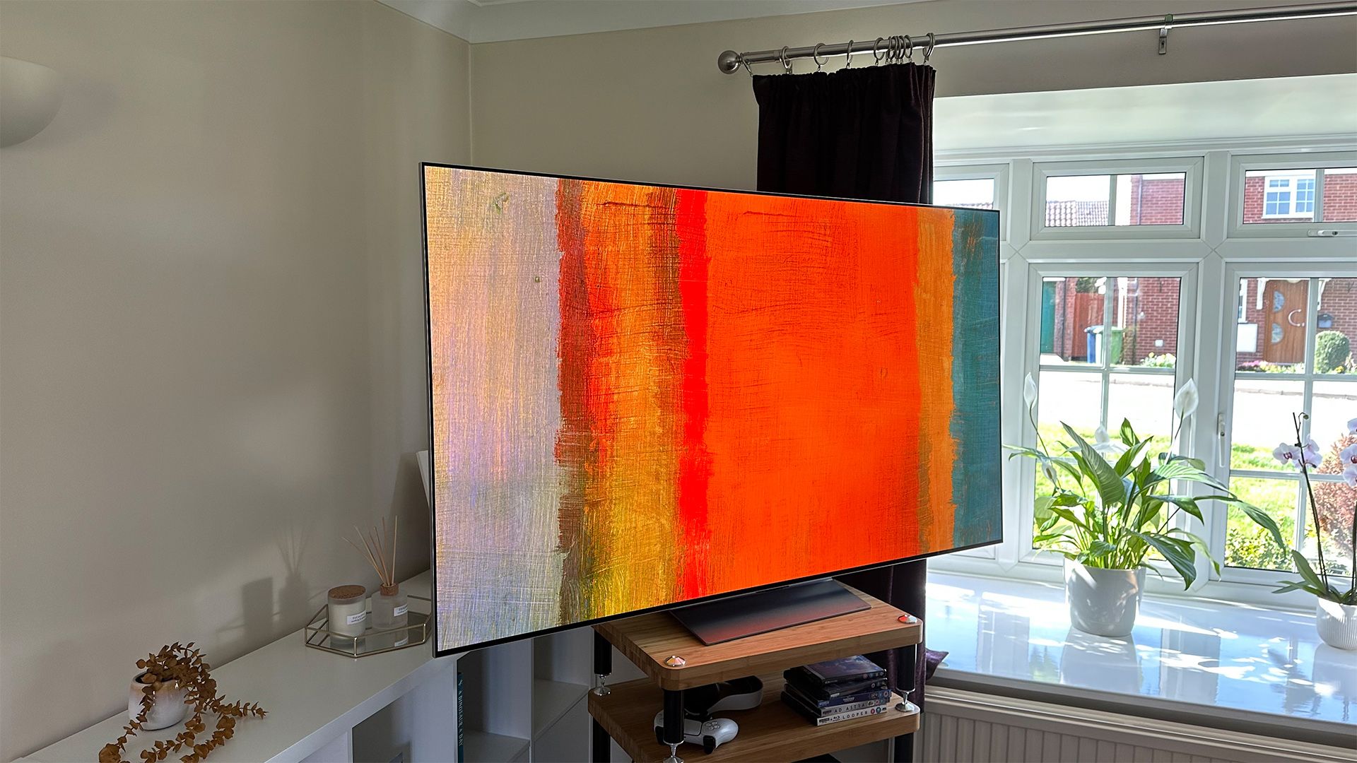

Whathifi testannut LG G3:n.
Kenties olennaisin poiminta, kirkkautta ja värivolyymiä tullut lisää, mutta hämärissä kohtauksissa värisaturaatio heikompi kuin G2:ssa.
Watching It (the 2017 version), we’re quickly struck by the extra brightness with which the G3 delivers highlights. The stained glass window behind Stanley’s head when he returns the Torah to his father’s office is significantly brighter than it is from the G2. What’s more, it’s also more vibrant, with the red part of the glass proving a great deal more vivid and, therefore, more realistic. This is a trait we see repeated time and again with the content we watch and it’s an interesting and important thing to note, as it suggests that concerns over MLA-boosted OLED TVs lacking colour volume in the brightest parts of their picture were unfounded.
Somewhat ironically, though, the G3 does deliver less saturated colours than the G2 in low-light scenes. This is most obvious in skin tones – when Bill and Richie enter the sewers their skin takes on a noticeably pallid complexion – but it also affects other picture elements such as the red balloon that floats towards Patrick as he also explores the sewers; this is decidedly pale from the G3 but vivid from the G2.
In all other lighting, the G3’s colours are generally more vibrant than they are from the G2, as seen in slightly warmer skin tones, a little extra pop to car bodywork, and a richer red hue to a sunset.
