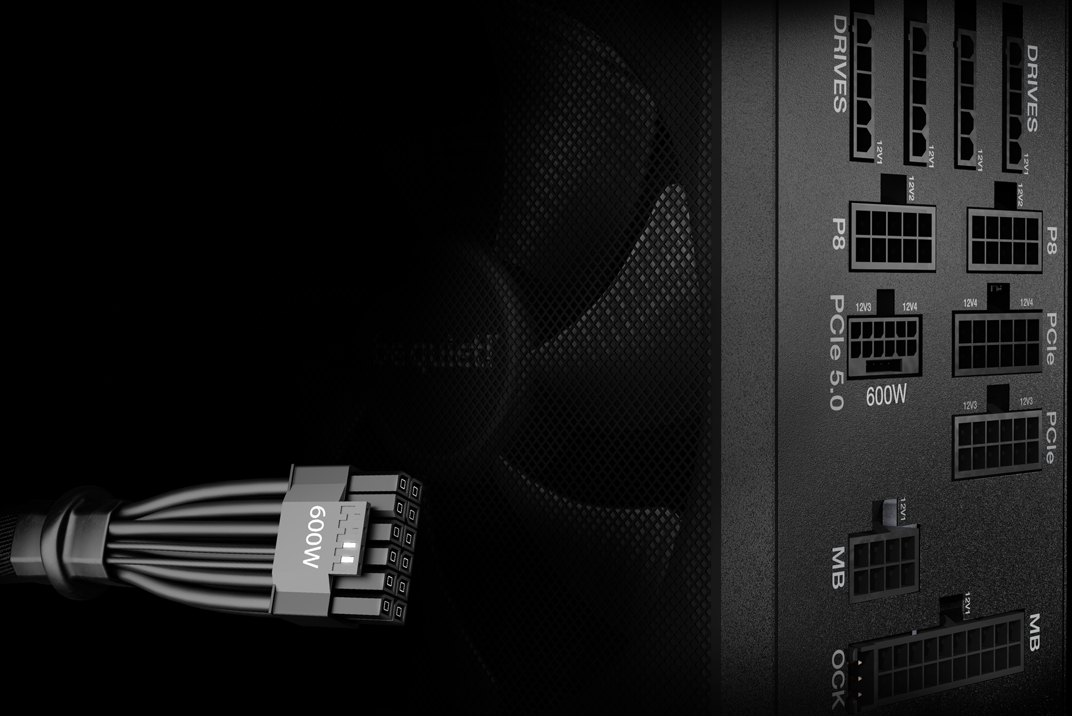

Voiko pitää paikkaansa nämä melkein 900watin piikit? Huhhuh.
Saisi vissiin ottaa 1800 W lyhyissä piikeissä hetkellisesti maksimissaan (jos olisi atx 3.0/3.1 poweri, mutta nyt ei varmaan semmoista välttämättä tarvita).
Tuo kuvan 20 ms aikaresoluutio ei välttämättä ole tarpeeksi tarkka.
High transient loads do not have a set standard in the PCI Express 4 design. The PCIe 5 specification not only defines the maximum average power consumption at 600 watts, but also limits short-term load peaks. With the new PCIe 5 standard, a graphics card is allowed to draw a maximum of three times its average power consumption in an interval of up to 100 microseconds. Using a 600-watt graphics card as an example, the maximum power consumption may not exceed 1800 watts over a period of 100 microseconds. For a period of 10 milliseconds, a maximum of double the power is allowed.
It is important to understand that the high load peaks may only occur over a very short time and the average power consumption in a time interval of 1000 milliseconds in our example may never be higher than the nominal power of 600 watts.
