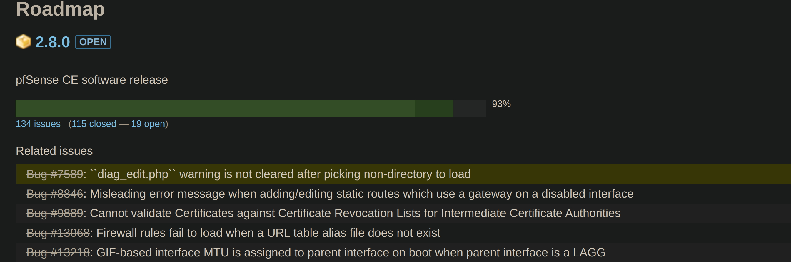

Mikäköhän tuon CE version kohtalo on? Ei aikataulua 2.8 versiolle ja OpenSSL 1.1.1 on EOL.
pfSense 23.09 plussassa tulee OpenSSL 3.0.10.
OpenSSL has been upgraded to 3.0.10 from 1.1.1 in FreeBSD.
This change was necessary as OpenSSL 1.1.1 reached its End of Life (EOL) on September 11, 2023. This means there will be no security patches for vulnerabilities affecting OpenSSL 1.1.1.
