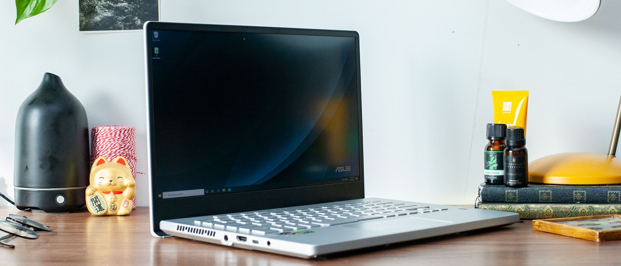

Tuossa olisi akkukestoa ja myös pelitehoa tarvittaessa. Numpad puuttuu toki jos se on dealbraker.
"While it may not get much use in gaming, the Zephyrus G14 also has a surprisingly good touchpad. The 4.1 x 2.4-inch touchpad has a glassy smooth surface, with clean, distinct clicks and good right/left click distinction, even if the actual clicking depth is a bit shallow. Multitouch gestures and two-fingered maneuvers all worked flawlessly as I used the laptop to browse, work and play."
