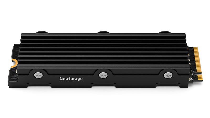

Tuollainen melkein sonyn oma ssd-laajennuskin tulee tarjolle. Hinta ei ole vielä tiedossa.
Sony has developed a surprisingly powerful aftermarket SSD for the PS5, but it comes through its Nextorage subsidiary.
PS5-Compatible Sony SSDSequential Read/WriteRandom Read/WriteEndurance
2TB Nextorage NEM-PA7,300 / 6,900 MB/s1,000,000 / 1,000,000 IOPS1,400 TBW
1TB Nextorage NEM-PA7,300 / 6,000 MB/s750,000 / 1,000,000 IOPS700 TBW
